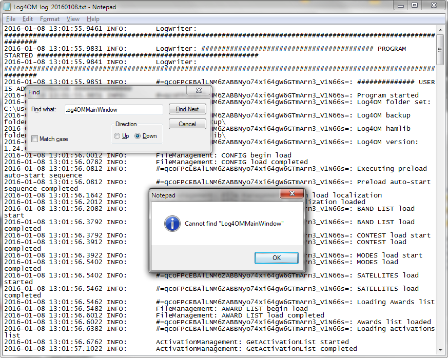

BTW, the last time in your log, viz Log4OMMainWindow: Database connected, does not appear anywhere in mine. It is not on the computer that I use for radio, but there is a log/database. Is this of any significance? If it is not, there's no need to spend any of your valuable time on it.
Functionality does not seem to be affected at all, v1.24 of Log4OM.
Re: Interface display
Terry is using an Alpha release, where form names are not encrypted.
This has been made to fix the issue with form placement not kept between different versions.
This is why you cannot find that string in your log.
In Log4OM 1.25 Windows placement will be correctly saved, and will be kept when V. 1.26 will be available.
Unfortunately the transition from 1.24 to 1.25 will still be affected by this issue.
