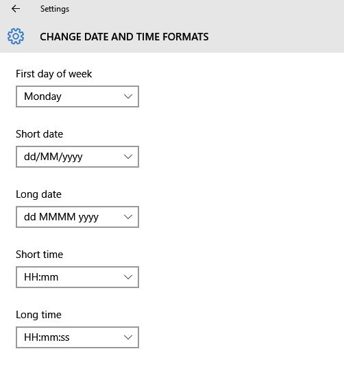

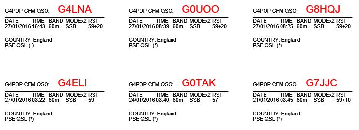

As you can see I don't have this problem and I am using Windows 10
You need to change the windows time settings, here are my windows time settings

Thanks Terry. I needed to restart my computer for the affecrts to take place when printing QSL Labels.
