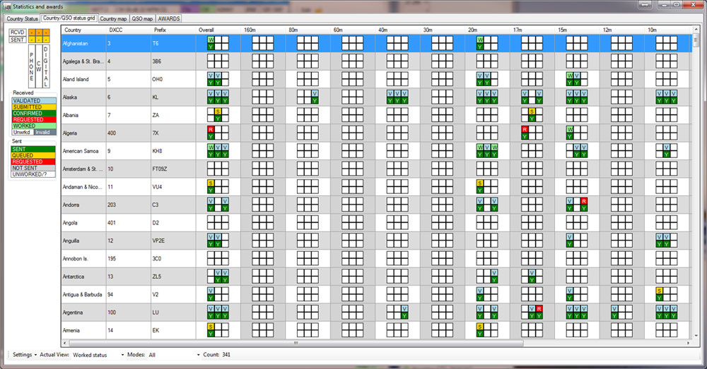

Have you tried the Statistics and Awards window, Country/QSO status grid tab? It displays the three modes Ph, CW, Dig for each band (column across) and for each country (row down) in one view.

Yes, Doug - the Country/QSO status tab does present what I need. And I can click on a particular band/mode and pull up the QSO's that contribute to it. I struggle a little with the Y and V distinction for received QSL's - not the definitions, but just that they look so similar. DX4WIN uses an asterisk * to indicate that the confirmation has been submitted and credited, which makes the grid a lot easier to pick out ones that still need focus either to work or get confirmations. Just a different style, and I'm sure I'll get accustomed to this format. Thanks for the suggestion!
