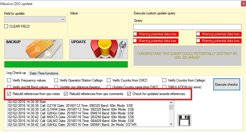

You could always use the included rebuild award references from notes and comments provided you have the award references in those fields

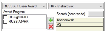

Hi Art,
Log4OM can't automatically define a Russian oblast or a Canadian province. The old Russian Oblast Award (with the oblast numbers) is obsolete, successor is the Russia Award or, more granular, the Russian District Award (RDA). Log4OM can track both awards.
I recently worked Alexander RW0CR on 30m CW. He gave me his RDA as HK-03, which means his 'oblast' for the Russia award is 'HK' - Khabarovsk - so I entered both in the award window (see screenshot).
You can do the same for Canadian provinces and many other awards. I also update all QSL records with every award information I can find on a QSL card (e.g. when I get them from my incoming QSL bureau).
If you click on "Utilities" -> "Statistics and Awards" -> "AWARDS" -> "Others" and select e.g. RUSSIA award, you can see all worked/confirmed oblasts. Same works for all other awards you track.
Please let me know if you have any further questions.
