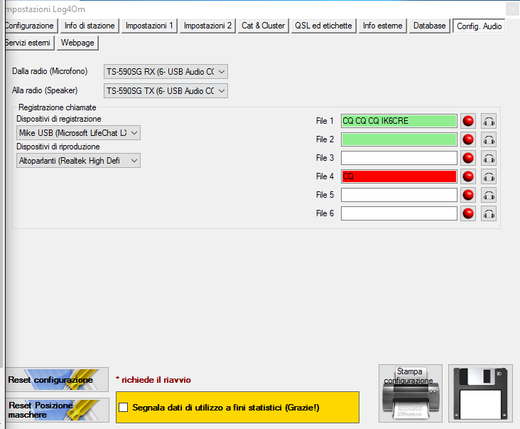

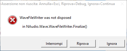

When I try to record my CQ in "Audio Config menu" I obtain the error "WaweFileWriter was not disposed in NAudio.Wave.WaveFileWriter.Finalize():
Anyone have this ?
TNX 73

Can you reproduce the issue and send me steps to repro?
Also you can send me by email a "support request" from HELP menu (only after issue appears) so i can check log?
pse add a reference to this thread in notes

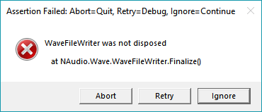

Same problem and same errors here
windows 7 64 bit
ik3gig fabio
any solution?

I have the same problem. Windows 10 64-bit..
Can we perhaps record the files and put them somewhere and manually add a path somewhere?

Same issue for me. I cannot record OVER previously recorded files either.
50% of the time it crashes Log4OM

Appologies for the delay in replying Rich but I needed to do some extensive testing.
I can now confirm that although everything works fine when you first make a recording that when you try to overwrite an existing recording that an error message is received.
Furthermore if you choose to delete the old message it is not deleted
I have asked Lele to look at this issue and will get back to you once it is resolved
