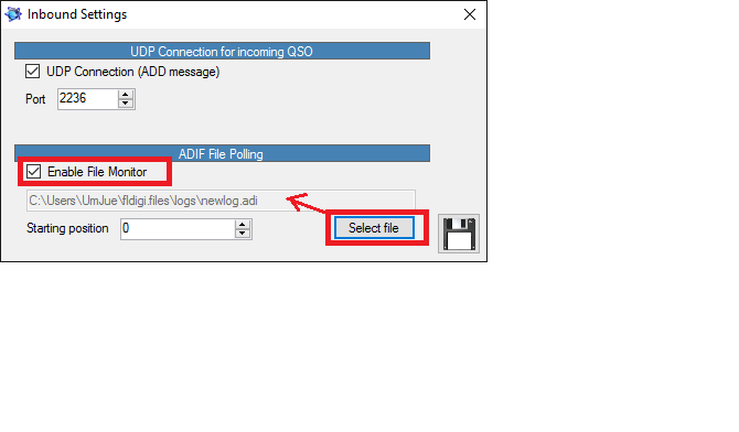

Open the Communicator Window and Stop the Communicator ..... Go to the Settings in the Communicator window and check the boxes for UDP connections (Port 2236) and Enable File Monitor (in Inbound). In the same window press the "File" Button and search the Fldigi ADIF ... If you find it double click on it at save all by clicking the Disk symbol in the Communicator window ....
After that close the Setting in the Communicator, hit the green START button in the communicator. Close Log4OM (communicator will close automatic) and restart Log4OM .... Start FlDigi, then restart Log4OM with Communicator, check that the correct frequency was shown in FlDigi, log a QSO and check in Log4OM it´s logged or not ...... Don´t forget to use the refresh button in the Log4OM F8 Tab ....

The NetGear settings is not important for Log4OM and FLdigi, and I discovered what is the case of my problem: I have changed the FLdigi logbook name !!!!
The first original name was logbook.adi and, from 1 month ago, the new name is changed in ik6awy.adi (in the FLdigi logs directory), and Log4OM not finds the old name!!!
