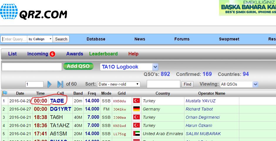

Yesterday i uploaded some qso to qrz.com by log4om, Than i checked on qrz.com webpage on browser, QSO time was incorrect,
for ex.real qso time UTC: 16:40 - Qrz log bokk same qso time is UTC: 00:00
What is the problem, How can is solve this

Re: qrz.com time

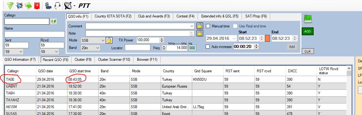

Hi Terry thanks for quick reply,
i checked my time zone settings but it seems normal. On log4om time is correct. Please look below pic.
- qrztime.JPG (100.19 KiB) Viewed 7439 times
- log40mtime.JPG (96.56 KiB) Viewed 7439 times

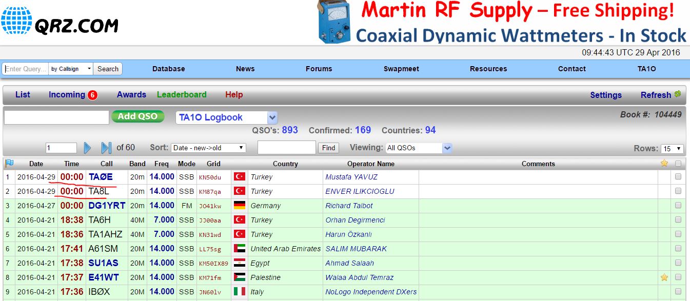

Re: qrz.com time
I send manually log (TA8L) to qrz.com but it is same, wrong time,
Before qso, i send the adif import process, so these ones have correct time.
Thanks 73s TA1O
Thanks 73s TA1O
- qrztime1.JPG (164.2 KiB) Viewed 7434 times

- Posts: 11605
Re: qrz.com time
The time uploaded by Log4OM to QRZ is correct as confirmed in the log file line belowta1o wrote:Thanks for advice,
i send to log to g4pop AT arrl.net mail adress.
73s
2016-04-29 12:55:45.5043 INFO: QrzComUpload: UPLOAD begin upload QSO to QRZ.COM Call: TA2DX Date: 20160429 Time: 125532 Band: 20m Mode: SSB
Later in the log file you try to upload the same QSO a second time and it's rejected as a duplicate, this is what should happen!
There is the possibility that there is a problem at QRZ??? Have you contacted QRZ?
