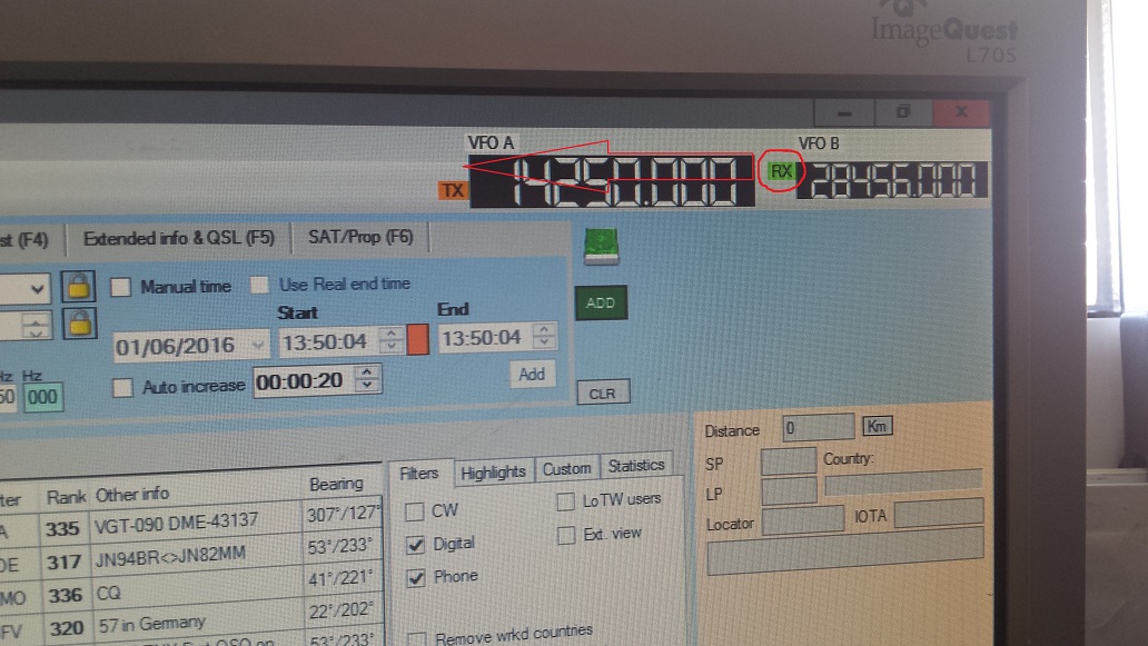

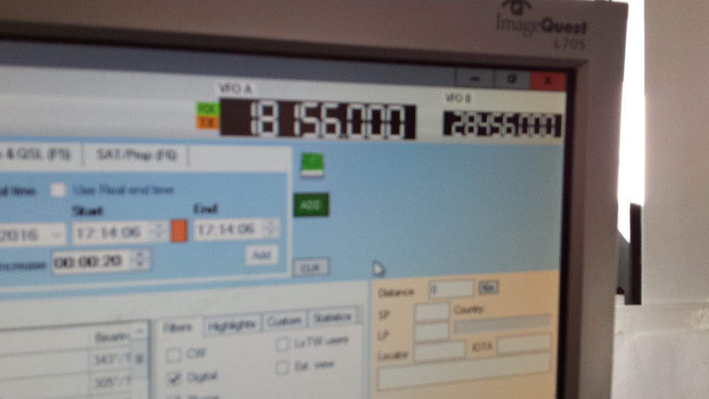

Sometimes, when I open Log4om I find that VFO B is not with A . . . My Rig is not in Split... I would like to know how to change from Log4om because sometimes I am running in simplex and all QSO are logged with VFO B ... and it is not correct...

It really helps if you provide more information :roll:
Windows version
Log4OM version
Make and model of radio
Interface cable type between radio and computer

I use a Yaesu FT 950 with SCU 17 Interface (Yaesu) with OmniRig.
I have 1.25 v for Log4om ... with Windows 10
Normally, I have not problems... I change freq with double click, etc . . . Only this problem...
This problem do not happens every time... Sometimes I switch on my Rig and It is OK, sometimes no...
Tnx
Jose EA5IDQ

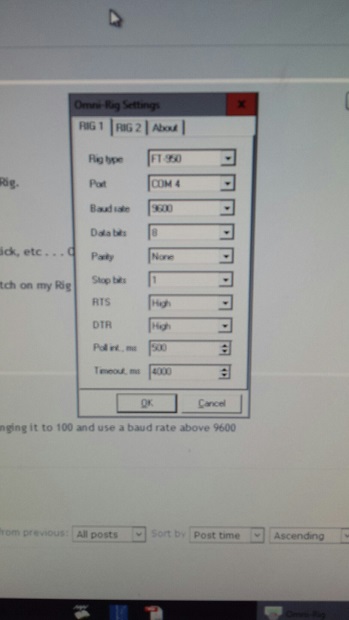

Sounds like the polling rate in Omnirig is set to low try changing it to 100 and use a baud rate above 9600

I change to 9600... I was on 4800 . . . but continue same problem... I enclose my Omni Rig options... Tnx

As I said use a higher baud rate - Above 9600 - 19200 ?????
Change the Poll Interval from 500 to 100

Terry... You are the Best... It seems that It is working good... I will test during few days... Fantastic... I will donate some €€ to support this fantastic Software... I am very very happy... and Of course... continue learning and reading in Forum...
