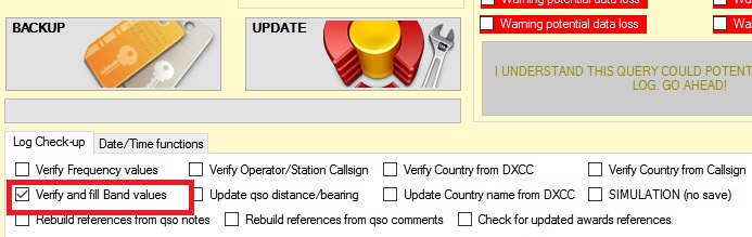

You can update the band by using our QSO Archive manager, see the highlighted function below

Thx for that !
That indeed helped the trick.
I was fighting with my logbooks to merge everything in Log4OM but i got it up and running now !
