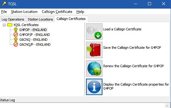

You need to understand the basics of how LOTW works which is as follows.
1. You must download and install, to the default location, the TQSL program from LOTW - This is used to prepare the correct format of file for uploading to LOTW
2. Once you have TQSL installed you need to use it to import your call sign certificate (TQ6 file) into TQSL - This enables the uploads to be signed (Verified) to LOTW - Please ensure that TQSL is functioning correctly before proceeding because if it is not then LOG4OM cannot work
3. The TQSL program is used by LOG4OM for upload to LOTW because it is the only way a properly acceptable file can be generated.
4. LOG4OM sends an ADIF file to your the TQSL program located on your computer and TQSL prepares a signed file which LOG4OM then uploads to LOTW for you. - To enable this to happen LOG4OM needs to know where the TQSL program is located so that is the path you inset into the LOG4OM options LOTW tab. See image below for guidance.
5. During the process of generating the ADIF file to be used by your TQSL program and the resulting signed file for upload LOG4OM uses a temporary directory to store the information (Temporary Path) - See image below for guidance but PLEASE NOTE your path will not have MY NAME in it
6. When everything is set up correctly with your user name, pass word and station location inserted in the LOG4OM LOTW options tab you then use the QSL manager to upload and download your QSO's to LOTW - LOG4OM seamlessly employs the TQSL program in the background while this is being done
Here is a screenshot of my TQSL window displaying the two active and loaded certificates (G4POP & G6CNQ) and two which are waiting for LOTW to certify (The /P calls)
Don't forget to ensure that the your call sign is correct in the LOg4OM Options/station details tab as well as the Options/External logbooks LOTW window
Perhaps this was a "Bit more informative"?
