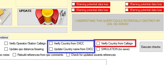

Have you tried 'Verify country for callsign' as shown below?
One other reason could be that you failed to check the 'Enable update' box in the main QSO Archive manager screen
