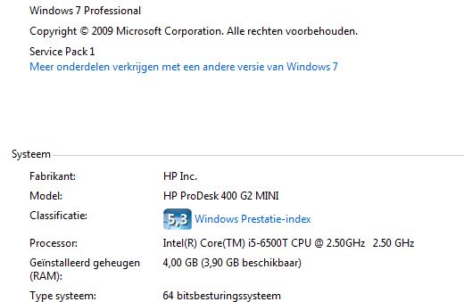

This is the system, and 22500 qso's in the log.
73 - Rudi - ON7CL

Re: Log4om getting slow
Hi Rudi,
should be enough "power" that your system has. The machine here is working with 8 GB Ram and 4 x 3600 MHz but i think that´s not the problem.
