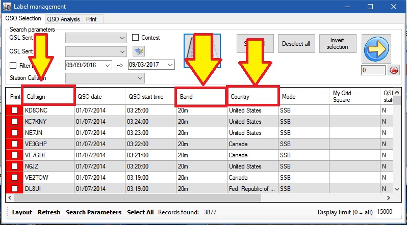

You can sort the order of the label print by using the normal Windows routine of clicking on the column heading title to change a sort order as shown below

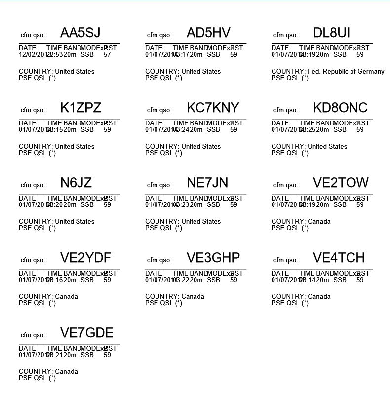

Below is an example sorted by call sign order order
And this one by country order
So you can sort by any column heading including DXCC number and additionally you can use the 'Search Parameters' button for a more refined list.
Also you can sort by your own station call sign by using the 'Station Callsign drop down at the top of the Label management window.
So for US cards outgoing from VE3 use the search parameters to select only the DXCC number for the US and then click whatever column heading you wish to set the sort order to callsign, county, state, CQ or ITU zone or if you recorded it the colour of his pants etc
The example below used 'Search Parameter' DXCC=291 to search for only QSO's from the USA
Then I selected the cards to be sent using the 'QSL sent drop down and selecting 'No-no'
Now I checked the selection boxes for the ones I want to get a QSL from
Followed by clicking on the column title 'Call sign' to sort alphabetically A to Z
Let me know what I am missing please?
