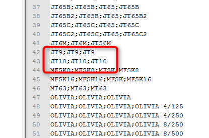

Open Log4OM, klick on HELP Button, klick on "Open configuration folder" ... look for modelist.csv and open it with Notepad++ or equivalent ...
Insert a row below JT9 and in this empty row type in JT10;JT10;JT10 then save and restart Log4OM that the change take effect.

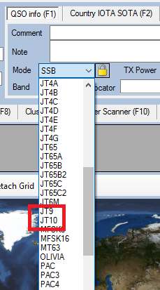

Working fine here with the changes i described .... Did you use the correct separartion with a ; betwee the first and second JT10 ??? Do not use : that´s the wrong sign. And b.t.w. have you restarted Log4OM after you make this new entry in the list ??
Here my screenshot .... I work with 1.28.0 too.

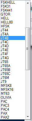

I did all as you advised. Please see my screenshots and see if you can spot anything wrong. Modelist.csv was the file edited.
Mni tnx es 73 de Guy G4DWV/4X1LT
