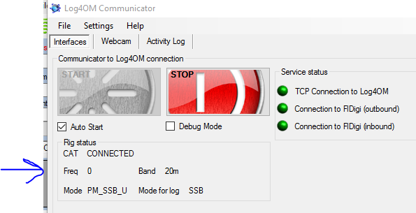

Good Afternoon. I am still trying to get the frequency to work on fldigi and wsjt-x. I have the Log4OM communicator working as shown in the picture above. I have no rig control on either the fldigi or wsjt-x program and am using the XML/RPC for fldigi.
As you can see in the picture above, I have all green lights and the rig status knows what band I am on (see arrow), but does not show a frequency.
as a test, I installed HRD free version and it works. I installed DX Labs Commander and it works. Both carry the frequency to the other programs and back when logging.
Is there some setting in Windows 10 that stops it from sending the frequency to fldigi and wsjt-x? Both programs are running with admin privileges.
Both will log the qso but neither give a frequency.

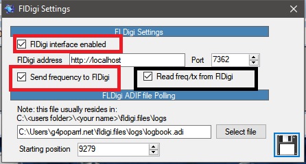

- Posts: 11605
Re: Log4OM not sending freq to Fldigi or JT65-HF
Did you check the three boxes indicated below?
and did you ensure the port numbers are OK?

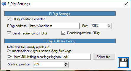

I checked those, and they look to me to match what I see in the manual???
I have partial success
I connected a different radio and all works as you directed me above.
So it boils down to this. The cat command I show in an above post does not not have a frequency to pass to fldigi when I have the TenTec Jupiter connected even though the frequency shows on the main screen. When I connect a Yaesu FT950 the cat command shows a frequency and passes it to fldigi.
Is something missing in the omnirig connection for the Jupiter?
