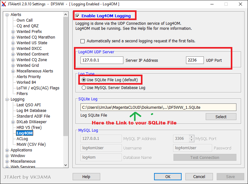

Re: Growler error 201 and email not configured
Hello Rob,
did you have installed the correct version of JTalert ? With the downloaded Installer you have
4 versions to install. 2 for differenz JT65HF Softwares, 1 for WSJT-X and one for JTDX. The
version fpr WSJT-X will have a red X as Desktop Icon.
Are the settings in JTalert o.k. .... (See attached picture but note that you must fill in the link
to your SQlite database
Note: Log4OM must be installed with administrator privileges and Log4OM must run when JTalert should log direct into it. ;) ;)

Thanks Juergen. I do have the lastest versions of wsjt-x and jt alert red to run ft08 with no problem. I noticed I have a different number in my 2333 UDP port which I can change.I already had the SQLite log file set too.When I downloaded the log4om a month ago I do not know if it was set as the administrator.Perhaps there is a way I could check this before I should continue.Thanks Rob K4my
K4my wrote: 26 Jul 2017, 23:31 Thanks Juergen. I do have the lastest versions of wsjt-x and jt alert red to run ft08 with no problem. I noticed I have a different number in my 2333 UDP port which I can change.I already had the SQLite log file set too.When I downloaded the log4om a month ago I do not know if it was set as the administrator.Perhaps there is a way I could check this before I should continue.Thanks Rob K4my
Should be 2236 then it will log
