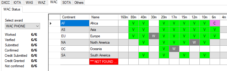

Hi Team
Just updated to v1.29 here. Checking Statistics & Awards > Awards > WAC phone is blank. If I check Mixed and then go to Phone it stays populated, but if I go to another mode like CW or Digital (which I don't have in this log) and then go back to Phone it again stays blank.
73 Tony YO3IPR / G4IPR
Statistics & Awards > Awards > WAC phone blank

Re: Statistics & Awards > Awards > WAC phone blank
Hi Jeurgen,
Yes, it's only a small bug. Your case is different to mine as I have no CW or Digital in this log, so when go to one of those it clears the grid and only shows the phone credits again after going to Mixed. The individual bands work OK.
I am using v1.37.0 and have noticed this "WAC phone blank" issue still exists. The symptoms are still as previously described. I realize that this really is a "tiny" bug as previously mentioned. Just a reminder for v2.0, which I am really looking forward to using. Thanks for the best logger out there !
Hi Tom
I had forgottten about this but you are right it's still there on the latest v 1.37.0 exactly as i described it before.
I now Danielle is still very busy with V2 development (I have a couple of other questions still open from recent weeks) but hopefully it's a simple fix (only affects WAZ, not other statistics as far as I can see) and it can go into the next maintenance release for V1.
73 Tony YO3IPR
It looks to me as if WAZ is working okay. WAC is where I see the issue. I always have to display the MIXED, to get the PHONE to display correctly.
