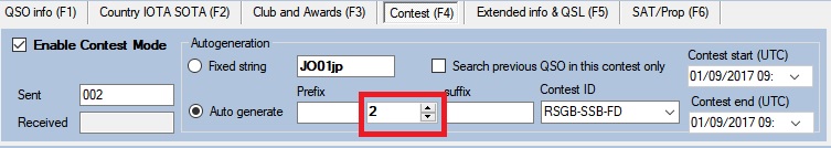

GE Folks, I have been using Log4OM since 4/14, but only using the log. I thought that I would try the contest log as I have always sent my logs in on paper and a dupe sheet. I went to the User Guide and then to page 49 and read the short description of its use. I clicked on enable contest mode and followed the items on page 49 and the sample on line. Do not understand why there is a 2 in the sent box indicating that I have worked 2 contacts. Under the heading of Auto Generation there is a box for fixed string???? I clicked on the Auto generate ok. Also, do not not understand the Prefix or the Suffix boxes. Could not find any info in the User Manual.

W3LI wrote: 01 Sep 2017, 00:13Do not understand why there is a 2 in the sent box indicating that I have worked 2 contacts.
No this is related to the serial number to be sent for that QSO and is set by the 'Auto Generate' field as below
Under the heading of Auto Generation there is a box for fixed string???? I clicked on the Auto generate ok. Also, do not understand the Prefix or the Suffix boxes. Could not find any info in the User Manual.
Some contest just require the same exchange every time (Fixed string)
