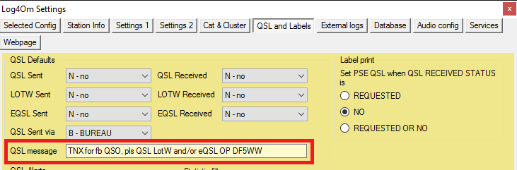

the "Comments" at eQSL are not the "Comments" in the ADIF specks. If you need a
QSL Message for eQSL and Labels you can put it in via the Setup/Options/QSLs and Labels.
See attached Picture:

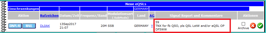

The following picture show the result of a test with my clubcall to my personal call:

QSLMSG is a recognised ADIF field as illustrated here http://www.adif.org/306/ADIF_306.htm and it is the field we use to send a QSL message (Comment for a QSL card) - Options/QSL and labels.
The received QSL message, if any, is displayed in the QSL Message column is selected by Layout.
