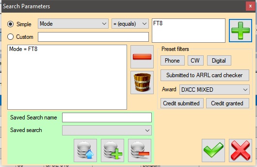

Posts: 11605
Re: Configurable window...
sq7bcn wrote: 17 Oct 2017, 06:48 But in the statistic and awards is also only Phone, CW, Digital ...
Sorry brain = finger problem
I meant to say 'Search parameters'
