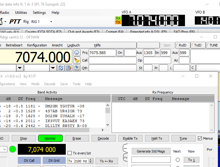

Re: Integration Logs of WSJ’s-x 1.8, Jtalert into log4om
I have tested a bit with the actual Fldigi 4.0.12 and all programs workin fine
together ....
First read the manua starting on Page 186 (Fldigi integration) and do all the
settings in Fldigi and in Log4OM communicator as described ... In Fldigi
Setup klick on "Initialize Button" before you close both programs.
Startup:
First start Fldigi followed by Log4OM, both softwares display the same QRG.
Now you can start WSJT-X followed by JTalert (we prefer logging with JTAlert).
Note: This is working only if you use Omnirig for CAT in Log4OM and if you set
your Radio settings in WSJT-X or JTDX to Omnrigi1 or 2 (if Log4OM is connected
to Rig 1 you have to use Omnirig 1).
ADIF polling is not needed ;) ;)
Hope this helps you and all the other guys like doing the same ....
