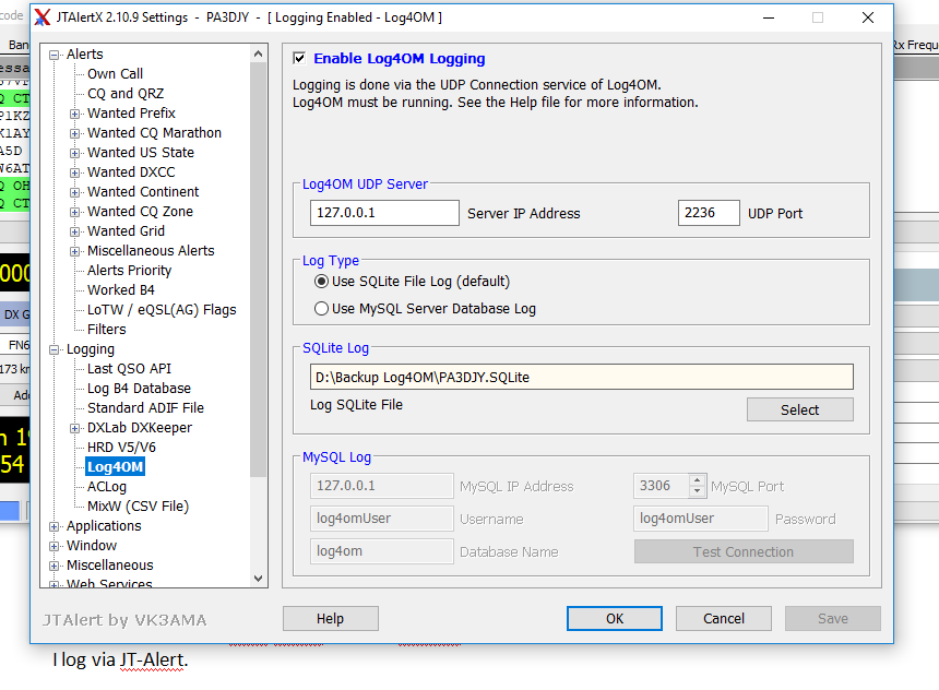

How do you log to Log4OM ? Via JTalert ? Are the UDP in Communicator and in JTalert are
the same ? If not set both to the same UDP Port. You can find the used Port in the Communicator
in Settings/Inbound Settings. On my end it is 2236 and my Port settings in JTalert are 2236 too.
UDP in WSJT-X is different (2237) but that´s o.k..

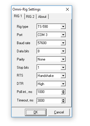

1. I use OMNIRIG as CAT.

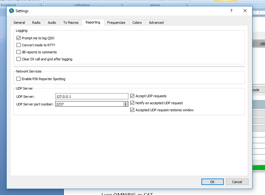

- Wsjt-x sttings.PNG (49.53 KiB) Viewed 8870 times
- Wsjt-x settings 2.PNG (39.92 KiB) Viewed 8870 times
- Seeetings JTALert.PNG (58.75 KiB) Viewed 8870 times

Adding Omnirig screenshot
- Omnirig screenshot.PNG (9.56 KiB) Viewed 8870 times

B.t.w. It´s not needed to check all 3 UDP Boxes in JTDX / WSJT-X settings.
On my end i have only "Accept UDP requests" enabled and that works fine for me.
