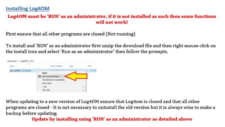

I sometimes wonder why I wrote the user guide and quick start manuals! This is clearly covered in the user guide and the Quick start Guide as below:
Also by the YouTube Video Tutorial Log4OM Quick Start Guide

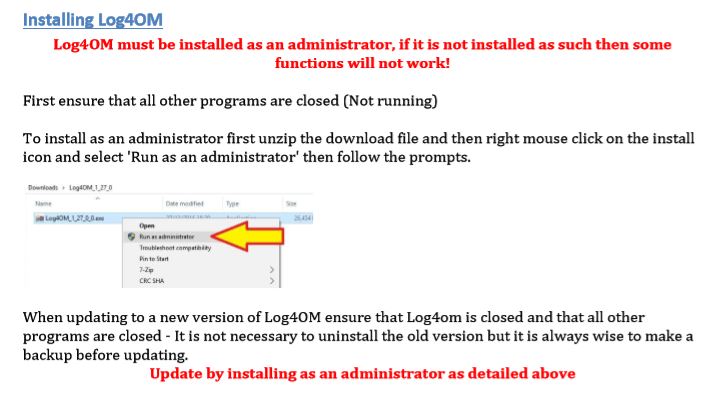

I would suggest that you amend the manual to read "Install with Admin Privileges" instead of as "Admin" along with a screen shot of the drop down as they are two completely separate things.
Just a suggestion as it confuses some.

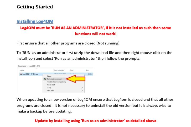

I have just re-written the user guide and Quick start guide and uploaded them to the website as below, Users will need to download the user guide in the Log4OM 'HELP' menu for these changes to be displayed.
Hopefully this will avoid any further misunderstanding's! :roll:
USER GUIDE
QUICK START GUIDE
