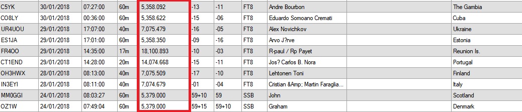

Fistly are you using Hamlib or Omnirig?
What data software are you using?
I ask because I am puzzled because the frequency display is and should be as shown below?

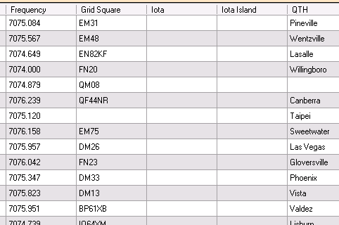

I am using WSJT-X with JTAlert. I was using the radio config that is in WSJT-X (TS-590s). I've never really had any issues with that at all - always worked fine. But, just before I read your post, I thought that might be the issue, so I swapped everything over to Omni-Rig and made a contact. It still logged as (this is an example...) 7074.123
Previously, I did not havce CAT enabled with log4OM as I am basically a digital (JT-65, FT-8, etc) operator.... I just enabled CAT in log4OM and it still logs in the format I have shown above. (but I like the extra info in log4OM with CAT enabled now....)
Here is a thought - as I log to a MySQL backend, I'm starting to think there is something about the field properties that is causing it to drop the first "." --- I exported a few log entries from log4OM to an adif file -- here is the weird thing about that; the first decimal point is there in the export, but not the second. I.e., 7.074123 is what the adif export has.
Take a peek at www.w7mgb.com and you'll see what I am getting. Attached is a snip from log4OM;
