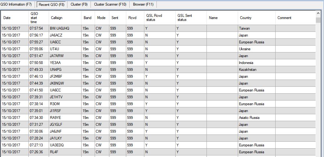

I just imported the ADIF file that you sent me into Log4OM and the QSL Status for sent and received is being displayed fine, see screen grab below.

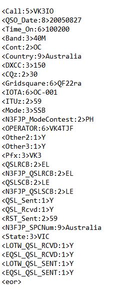

Here is a screen grab of one QSO from that ADIF file
If the information is not available Log4OM cannot display it!
Some of the fields that start with <N3FPJ... are program defined fields which do not conform to the ADIF standard so we will not use those fields

Get N3FPJ to export in a complete and up to date adif format including the QSL, LOTW AND EQSL status and date fields.
Same old same old "Garbage in garbage out" or in this case wrong information results in lack of data
