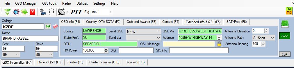

Trying to figure out where Log4OM pulled wrong data from so I can run down issue. I dont think it happens often but want to make sure I dont have something wrong.
Finally saw a South Dakota "SD" station on 17 meters Ft8. Its the last state I need on 17 meters. I worked him and logged it. I noticed on QRZ it was not showing as worked under SD awards. I checked QRZ log and he was showing as AZ.
So I checked log4om and sure enough it was listed as AZ. JTAlert had it correct at SD.
So what is the lookup sequence as I think Log4OM is pretty intelligent and checks many ways.

What was the call sign?? Helps if we have all the info.

Well it looks it up as SD using QRZ lookup in Log4OM for me!

Not sure how it happened. JTAlert had him as SD but correct grid in AZ. He is in AZ even though everything online with FCC points to SD.
So log4OM changing it to AZ was correct even though manually entering it into Log4OM still shows SD !
