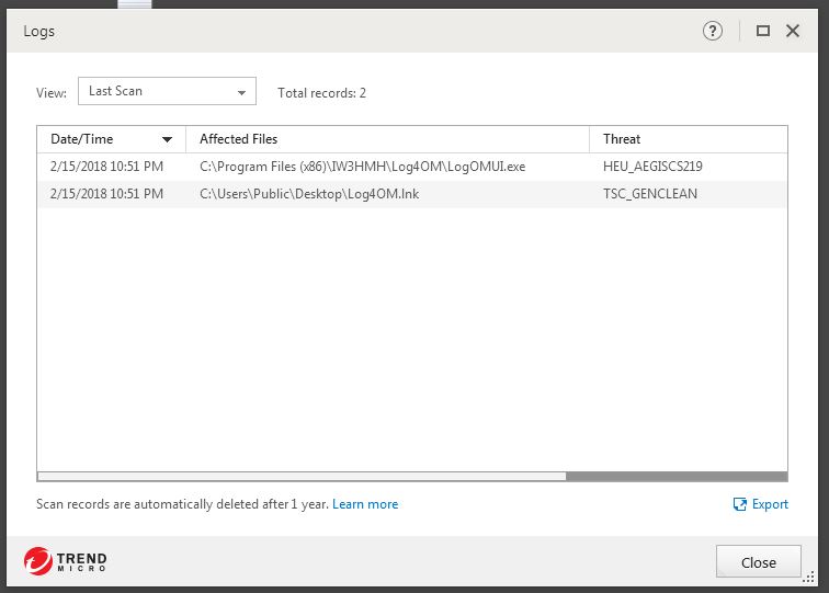

I'm currently evaluating both Log4OM and DxLab. I installed Log4OM this evening, downloading it directly from this site. Trend Officescan, my virus scanner identified the installer as possibly malware. I had read here that this sometimes happens with anti-virus software, so I bypassed that. Installed Log4OM, did the basic configuration, created a database in My Documents. I had some trouble getting OmniRig to work. I had to install it manually (even though I'd asked Log4OM's installer to install it), and then had to download the radio ini files to get one for my IC-7300. It still wouldn't talk to the radio. Yes, I was running Log4omUI.exe as administrator. Yes, I know about COM port number, baud rate stop bits, etc. Windows 7 (Professional x64) firewall asked me a couple of times if I wanted to unblock certain things while setting up Communicator, and I said yes, unblock.
Then I was fooling around with the configurations, starting and stopping Communicator, trying to get OmniRig to talk to the radio, when suddenly I got the errors you will see in the attachments. Sorry, I can't tell you exactly what I did when it happened. Officescan terminated Log4OM and actually deleted the Log4OMUI.exe file and its desktop icon. I was pretty shocked, because I had just told Officescan that Log4OM should be trusted to modify files in My Documents, (asking this the first time it tries to write to a file in My Documents, etc. is a part of its anti-ransomware feature).

Thank you, Terry and Daniele. I had another go at this today, following exactly the Quick Start Guide. No joy, unfortunately.
So far Trend Officescan has blocked as malware:
The install file/
The .TMP file that is created during installation.
logomui.exe
logomcommunicator.exe
rigctrld.exe
Dealing with this is like playing Whack-A-Mole. I whitelist one file, and soon it blocks another as I'm trying out the program. I'm sure it is heuristic analysis of behavior that is triggering most of the blocks, because the warning names with HEU. As Daniele noted, since the files are encrypted, I don't get a warning when I scan them, only when they are run. No matter what I do, I can't get the CAT connection to work. I tried both Hamlib and OmniRig, I've gone in and out of the program, I went down to slower baud rates. Nothing worked--and I have both DXLab and Fldigi successfully talking with the radio. My guess is Trend is preventing something from running, causing odd behaviors from Log4OM as well as the warnings.

PROBLEM SOLVED! I was able to finally get Log4OM working by doing two things:
1. I turned off the virus checker during the install. This prevented "Whack-a-Mole" virus warning popups, which in my virus scanner will disable a program component if you don't click fast enough.
2. I explicity whitelisted LogOMUI.exe and LogOMCommunicator.exe in the virus checker's exception list before running the program and setting it up. On my Win7 system, the programs are in this folder: C:\Program Files (x86)\IW3HMH\Log4OM .
I'm posting this for the benefit of future users who encounter this. My virus checker is Trend Officescan, but I suspect that other virus checkers may cause similar grief in future. As the bad guys get smarter and more devious, the virus checkers have to get stricter and more aggressive, and will step on legitimate things more often.
