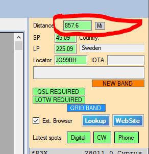

The only dispay of miles is in the field shown in the screen shot below.

Main window right side above the cluster. Type in a callsign and a locator and the miles will be shown there.
