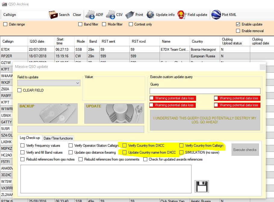

Why not use the QSO Manager to update the country names

I did not know there was a possibility by the manager. I try now. Thank you.

it's good it worked.
All the countries are now informed, and I had duplicates.
Thanks for the tip Terry.
