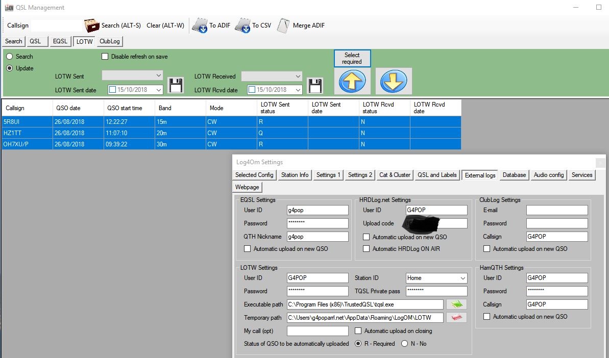

What have you got selected here
With R selected it should filter all QSO's marked Requested and Queued
With N selected it should filter QSO's marked No and Queued

Looks just like you show with "Required" checked by default.
It works on closing and says there are records to upload.
But doing it through QSL Management doesn't work.
