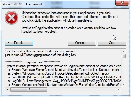

From yesterday after update to latest from previous the following errors are occuring, when submitting LoTW contacts for upload Log4OM (TQSL) continues to see some duplicates and asks if i wish to ignore these, if i do the upload will hang and not upload until I cancel in Task manager or Log4OM, an upload works with Tqsl and HRD Logbook. With total uninstalls of Log4OM and Tqsl and rinstalls both fresh all appdata removed the error still occurs with latest release.
This started with an update to the release yesterday any assistance would be appreciated
What previous to latest? TQSL, Log4OM or October Windows updater which is know to have problems!

The update yesterday of Log4om to version 1.34, the previous log4om version i had installed was 1.33.

mm0hvu wrote: 14 Oct 2018, 22:04 The update yesterday of Log4om to version 1.34, the previous log4om version i had installed was 1.33.
Did you install to run as an administrator as in page one of our user guide?

I did install as admin as the guide instructs as i always have.
Re: LoTW duplicate upload error
Please send a support request to Lele by email using his email as shown on QRZ for IW3HMH
