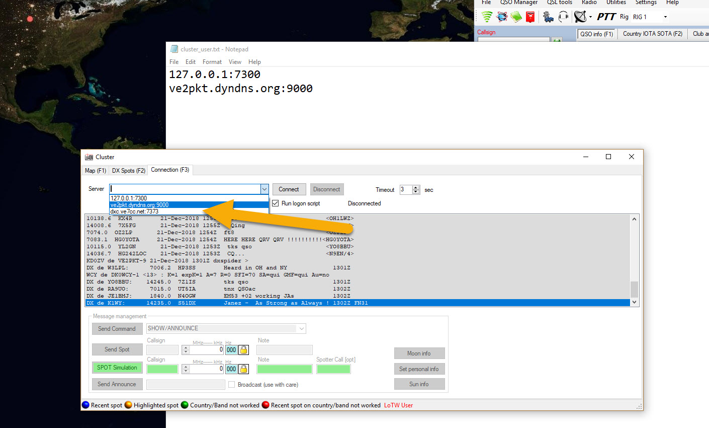

I am not seeing a way to manually edit the Cluster list. I know changes are coming on V2 but until then I would like to limit my cluster list to the online server of choice and localhost:7300 which is an aggregation server feeding all my CWskimmers.
Any way to do this?

Options/configurations tab - Check expert mode box, click on clusters, edit the text file, save and close
See user guide for full details of expert mode

Apparently VE7CC has been down a couple days. Every time I start the cluster it defaults to VE7CC. I have removed it from the cluser_user.txt file and restarted Log4OM.
VE7CC still shows up and it always tries to pick that cluster and errors out. Where is this coming from? Is there something else I need to change?

Did you restart Log4om?
