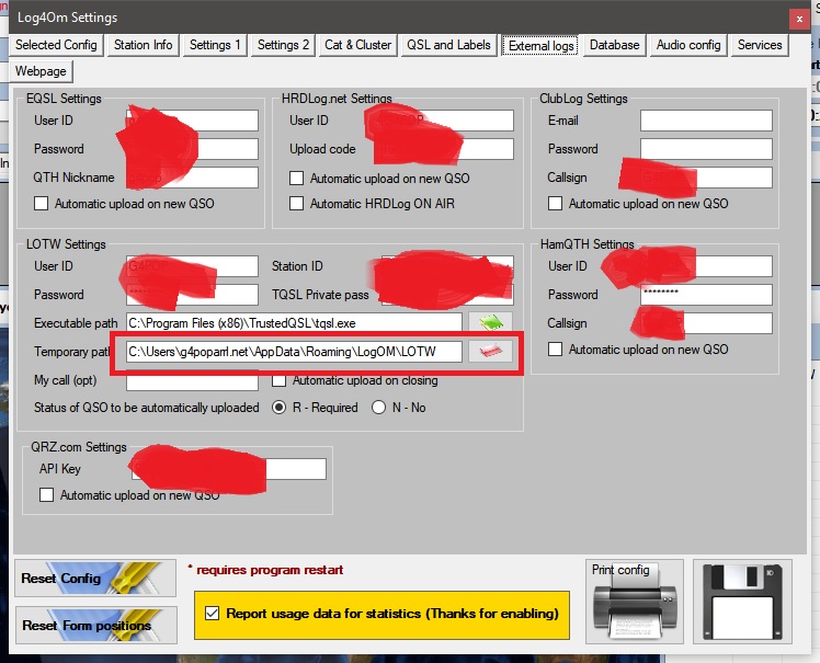

Where does the temporary LOTW adif file get saved on an LOTW download?
Thanks, Glenn KD0Q
Posts: 11587
Re: LOTW download file
Whatever path you have set here.

That's what I thought but it doesn't show up there. Any ideas why?

I found that the LOTW adif file only exists after the download operation if the "Debug Mode/Log Level" is set to "Debug Level" or higher.
