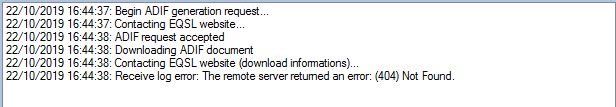

I am getting the same problem with eQSL, it worked perfectly till today.
Log4OM V1.39.0.0 uploads to eQSL, but refuses to download any replies and gives an error as per the attached file.
Hopefully I've done something stupid, but been trying to rectify this all day
73s
Doug
G4DZU

I looked at the config file and agree, I can reach all the URL's. (Version 1.39)
I tried changing them to http as this was mentioned in the post on the eqsl site about the migration of their servers, this had no effect and I still get the same error as reported by myself and DougG4DZU
It looks like the ADIF file is downloaded ok, but the issue appears to happen when downloading the inbox, going to the website https://www.eqsl.cc/qslcard/DownloadInBox.cfm
I see the following notes:
NOTE: October 22, 2019 the folder structure changed. Look at the hyperlink for the location of the file if retrieving this via an external program ........

Ok, got it... checking
- Posts: 2988
Re: Unable to download logs from eqsl - 404 error
Expect a new release soon.
