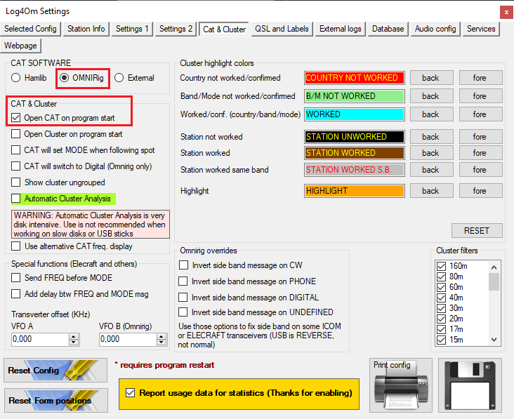

See my CAT and Cluster settings page. Have you checked the Box "Open CAT after program start" ?
Shure that you have installed Log4OM as Administrator ? As i say, anything can be possible and i´ve
forgot also intalling as Administrator in the past.

Thanks for the reply and info. I believe that my Omnirig screen is set up like your screen, but I will check. I thought the issue was strange since CAT has always worked. I won't be able to check until a few days from now, but I will get back to you. 73
