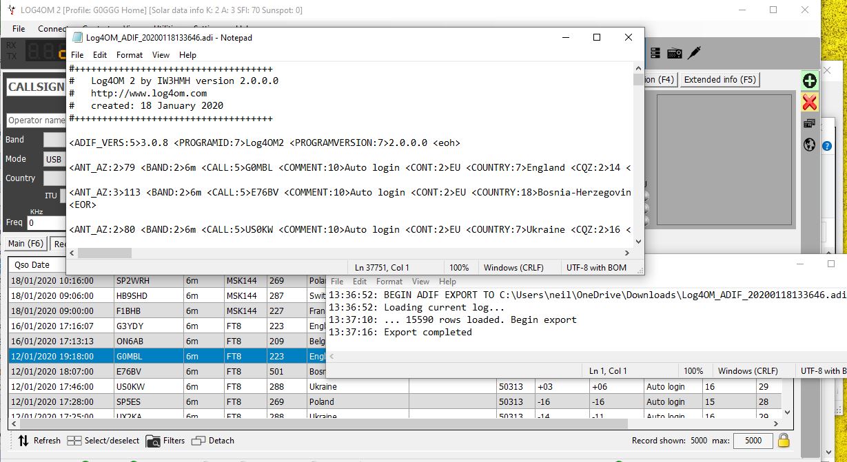

Looks like a strange bug, initial V1 was imported via Import ADIF.
I've add a few FT8 QSOs via gridtracker which look ok in Recent QSO's view.
But when a Export ADIF is generated whether Full or Standard the log shows no error, but the generated file does not include any of the QSO created in V2. The QSO count looks good and log indicates all QSOs are loaded
This could be important if the function is used for backup.

Further test I download via Import ADIF a few QSOs and created manual QSO using v2.0.1.0 all appear ok in Previous QSO Tab
The Export ADIF contents remained as before, definitely regenerated the file indicated created under v2.0.1.0
Thanks Neil
Thanks Neil

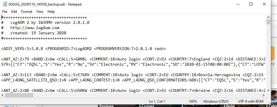

Hi Doug,
I've just checked automatic backup file, none of the new QSOs after the initial load are included. I hope this is just a funny issue with my load, otherwise you have a bigger problem.
Neil

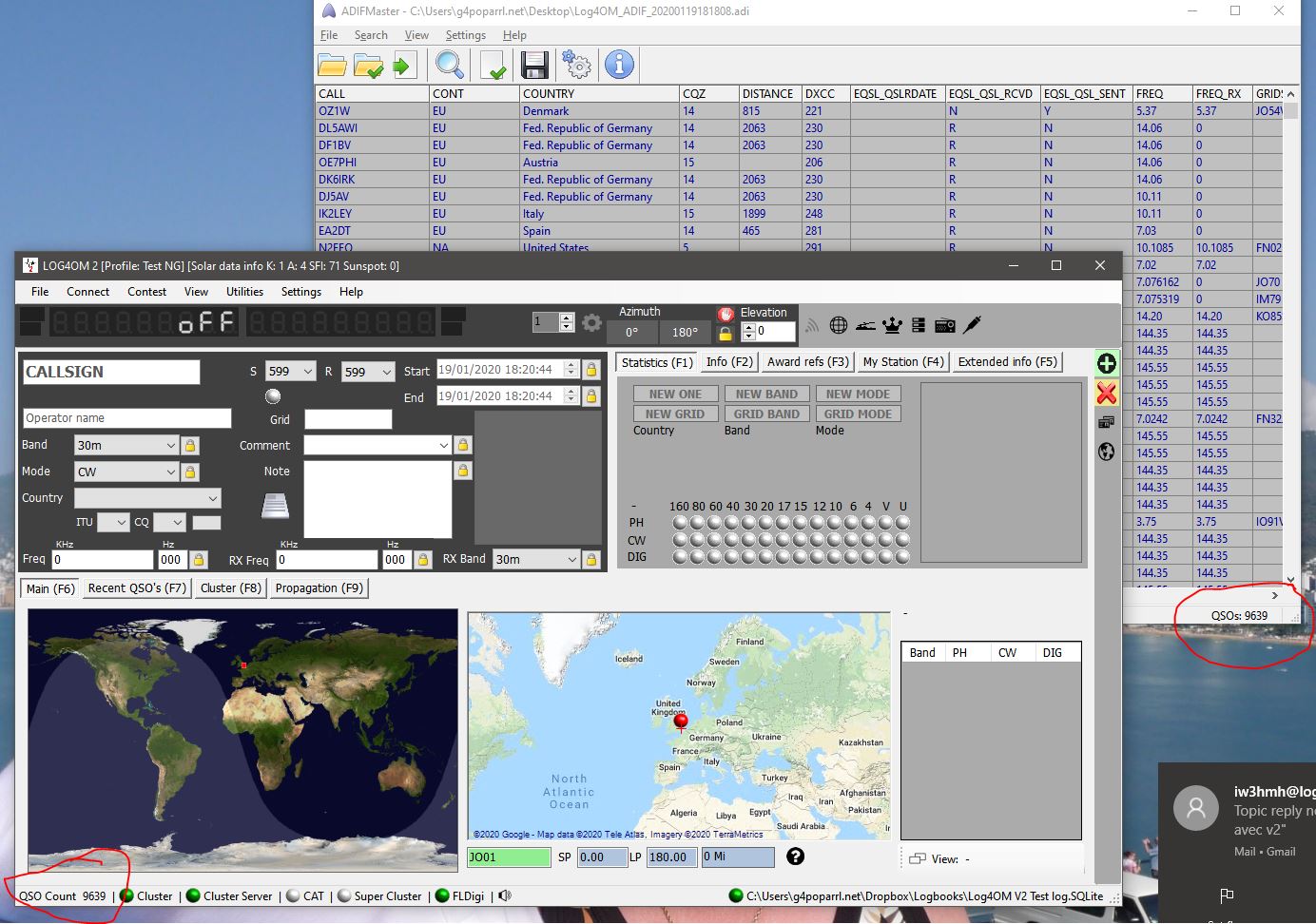

Do me a favour and open the ADIF file in AdifMaster (Its a free program) and compare the QSO count in ADIFmaster to that in Log4OM
Re: Export ADIF from menu
Sorry, my mistaken I can see what is going on with ADIFmaster.
I do a lot of processing of exported ADIF files, loading into Gridtracker on V1 when an export is produced the latest QSO was alway at the top on the file. Here on V2 exported adif the initial load has the last QSO first, but any future QSOs and dataloads are added the bottom of file.
Thanks Terry & Doug
Thanks Terry & Doug
