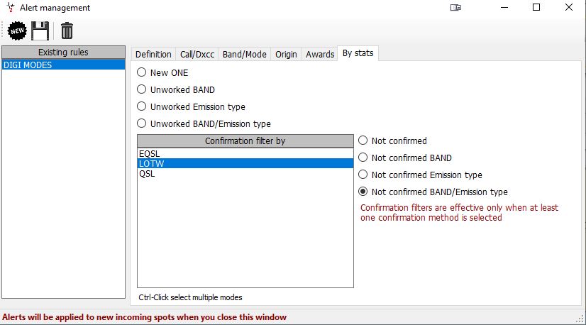

Hi Rich,
that's how I setup alerts. This way I get an alert if the spot is not confirmed on LoTW. Hope this helps

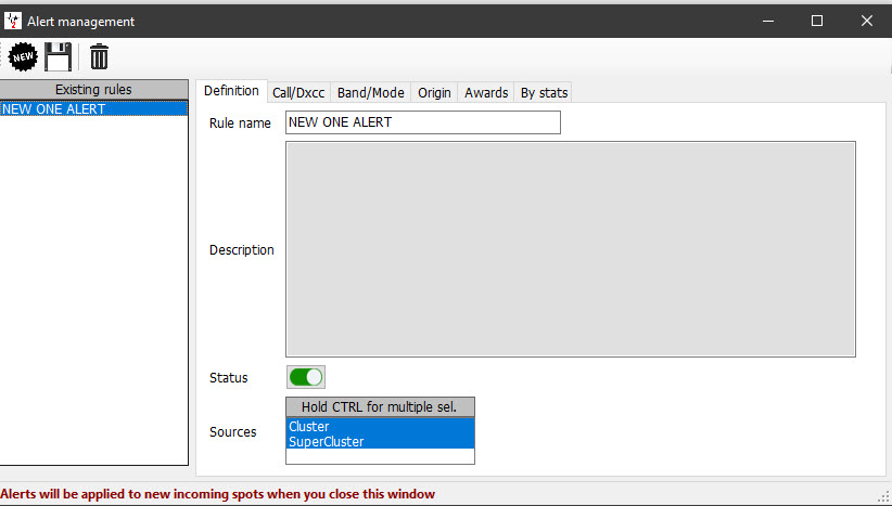

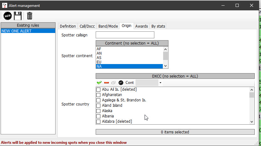

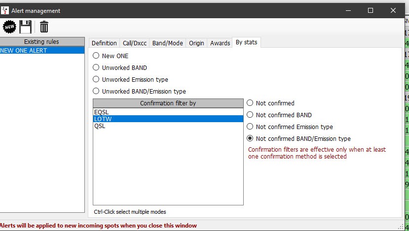

Well the only screens I have configured are below

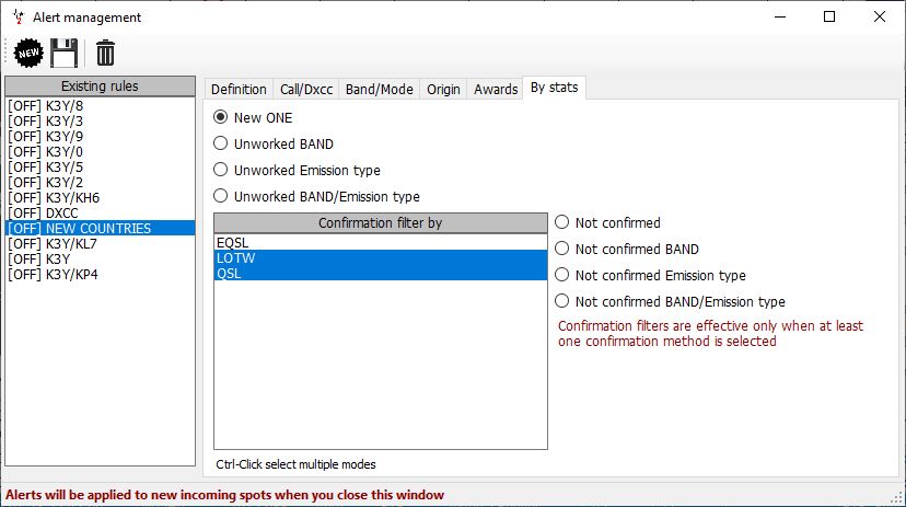

Here is one I created for CW. I labeled it New Countries. Screen Clips below.
Once created be sure to toggle it ON. I've forgotten to do that a number of times. ;)

KD0SV, i was also able to replicate your issue. Seems the Alert logic has difficulty when more than one criteria is set. In your case (thanks for the screen shots!) you have a By Stats set and an Origin set.
Here is a workaround. Eliminate the Origin criteria. I did and it is working for me. Also, you could filter your spots by NA spotters either at the Cluster level (preferred) or on the Cluster Filter tab and end up with the same results as two alert criteria.
