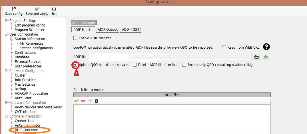

Check options below Adif adress line ,
Thierry

I checked the box as instructed but it will not stay checked when save/exit. Next time I enter it's unchecked.

I don't think you need to check the box in Configuration/ADIF Functions.

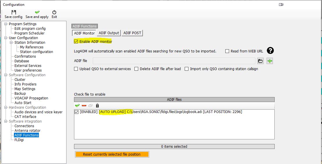

All those fields are saved when you create the rule. You can monitor different files and have different needs for each of them
If you need to change a rule, adding new parameters, remove the rule and recreate it with the parameters you need.
This flag is NOT working for each ADIF imported file but only on those that explicitly you marked with during the creation.
If that is not working this way please return to us with a report so we can check it

Works as expexcted for me. Logging QSO in FlDigi will upload the QSO to external services automatically.
