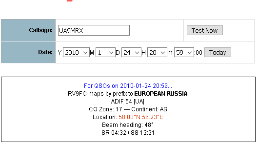

CIao Sandro
we use as source the archives in Clublog.
Can you check some of the calls of your list in the clublog callsign checker, with correct qso date?
About Macedonia and North Macedonia, you're right. It seems ADIF committee is sleeping on it... we moved according to official rules but, yes, it was a choice.

Hi Lele
Good idea and solution.
I register to Club Log and verify some of the calls.
Club Log.PNG (6.74 KiB) Viewed 2932 times
This is an exaple, with call in europe but is in AS
