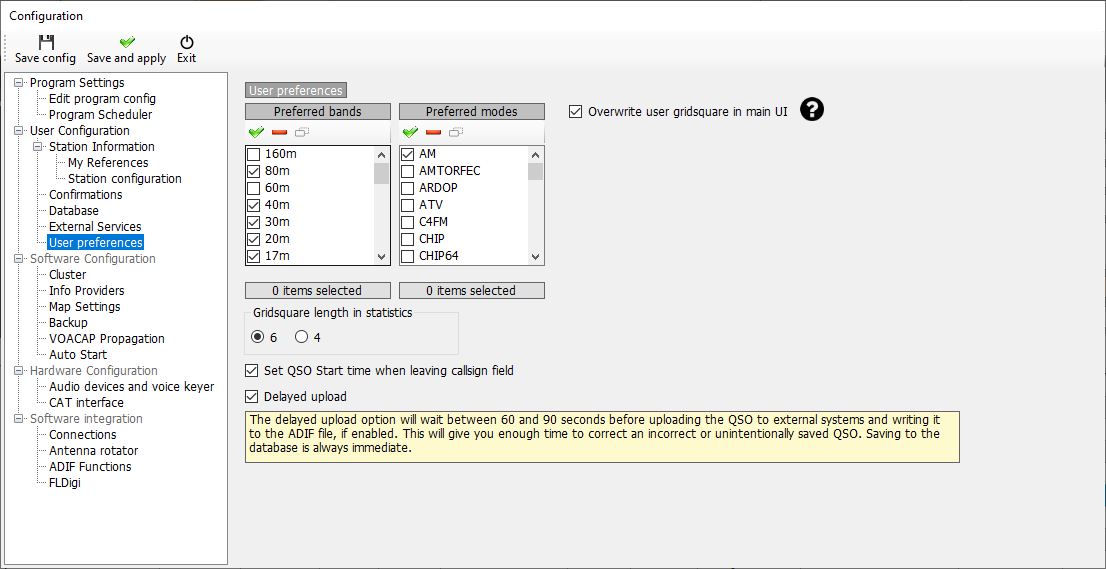

Check Configuration / User Preferences: Tic box for "Set QSO Start time when leaving callsign field"
Works quite well.
- V2-Configuration-UserPreferences.JPG (85.29 KiB) Viewed 2559 times

Thanks for the reply Nolan.
I had that checked but opted to un-check it since I often propagate the call sign field to see if I've already worked someone or where they are and such and don't always actually contact them...so had hoped for another way to accurately set times.
I suppose if/when the developers add a set of start/stop buttons I'll use those, but until then I'll simply use the lock buttons as described above.

Thanks again Nolan - I thought leaving the field to start the clock did something else, for some reason...and now see it does what I need it to.
Appreciate the replies!
