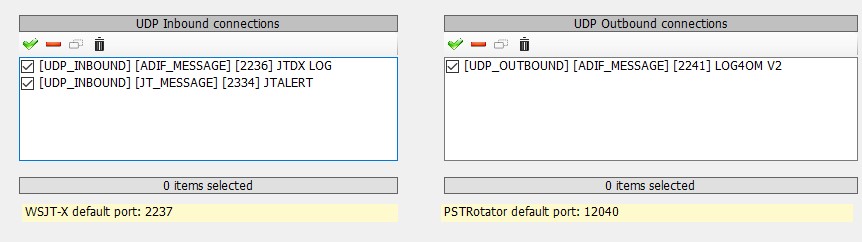

Juergen this are the settings here i must fix something ?
Aantekening 2020-02-02 163857.jpg (41.36 KiB) Viewed 3423 times
Re: Log to LOG4OM
As a first look i will say stop JT_Message

Ok Juergen the problem fix now tnx for the info.
