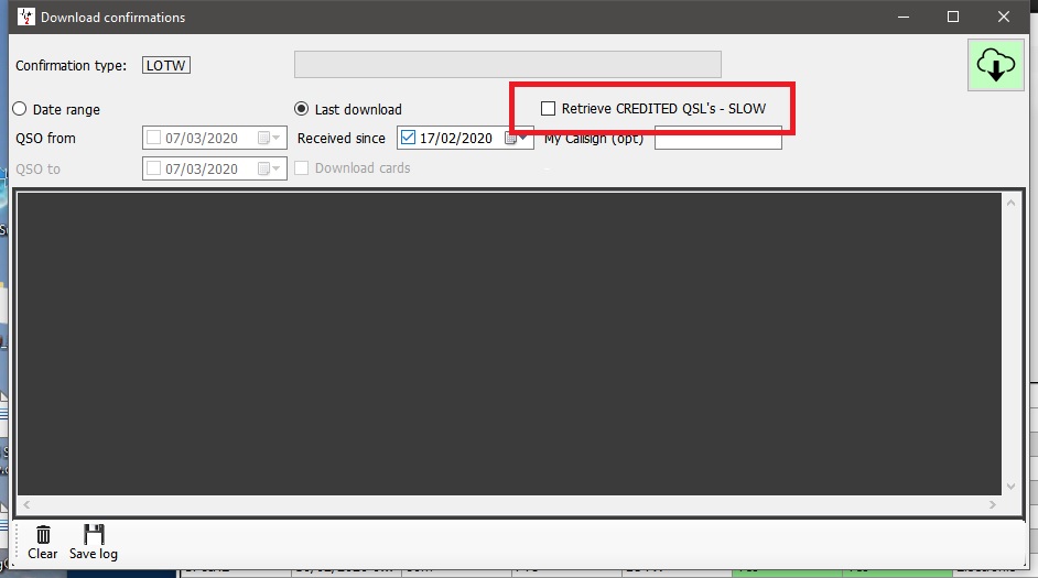

Re: dxcc - wrong status
Hello Don,
there´s also another thread with the same problem (Granted to Validated change). Lele has fixed something in
the past but it is necessary to do a complete new download from LotW from first QSO on. That should be correct
the entries from Validated to GRANTED if a contact is granted on LotW website.
