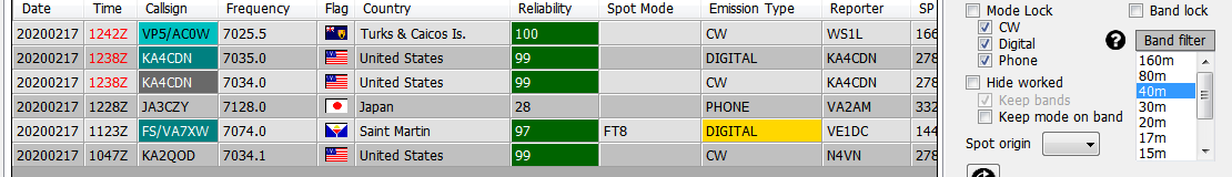

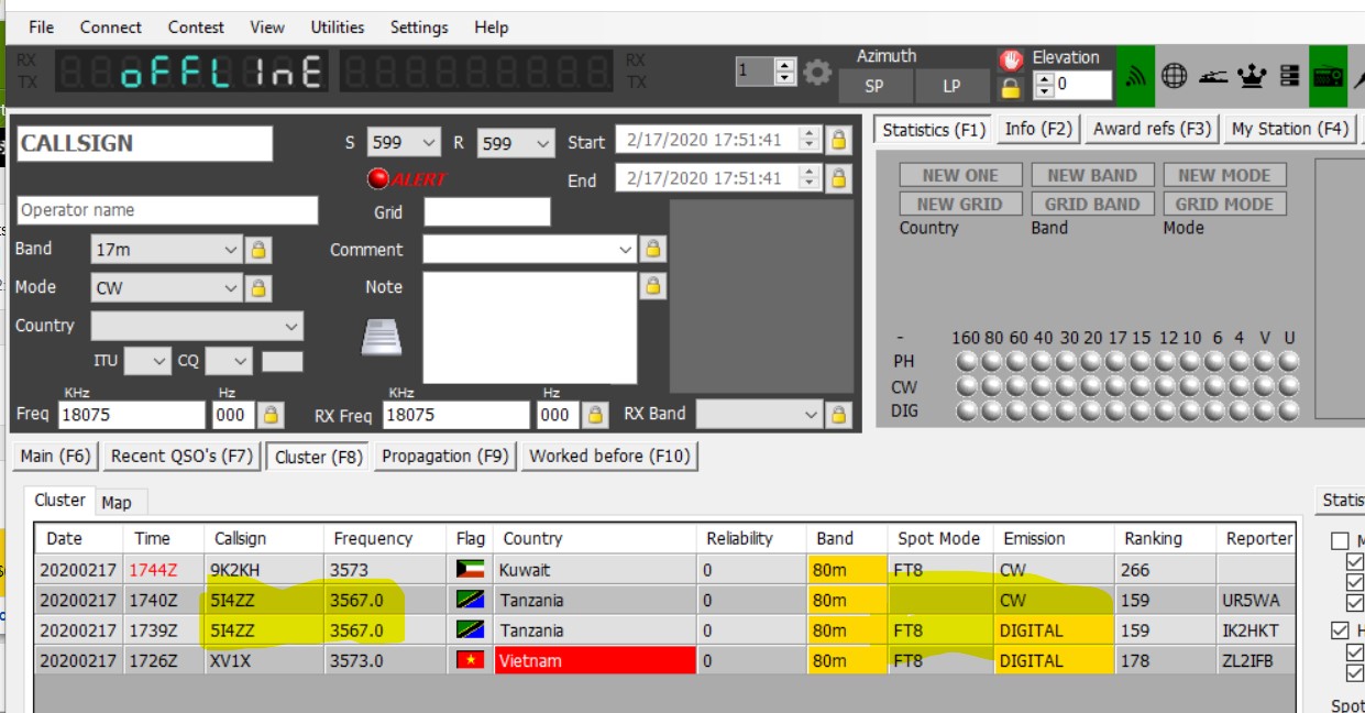

I tested changing my bandplan_dxcc291.xml file and saw that it did change how the spots are categorized visa-vi Emission. It seems the Spot Mode is based on the top stuff in that file, SpecialFrequencies, although I'm not clear what is done with Spot Mode, what the purpose is, since I don't see how to filter on it.
There seems to be an abnormally. Some spots in the Cluster (F8) grid for the same frequency are marked as Emission DIGITAL while others are PHONE or CW. See below. I'm thinking that this is because one of the spots is via the Cluster while the other the Super Cluster?

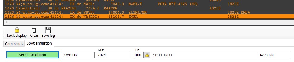

I don't know. Above is the result where I simulated myself with NO FT8 comment. It is marked as Spot Mode FT8 I assume from the SpecialFrequencies entry. Yet, BH1VCS came in right after my simulation spot. It is not in the my telnet cluster log so it must have come in via the SuperCluster. The Spot Mode is FT8. So why is it marked PHONE?
Spot Log and simulation entry:

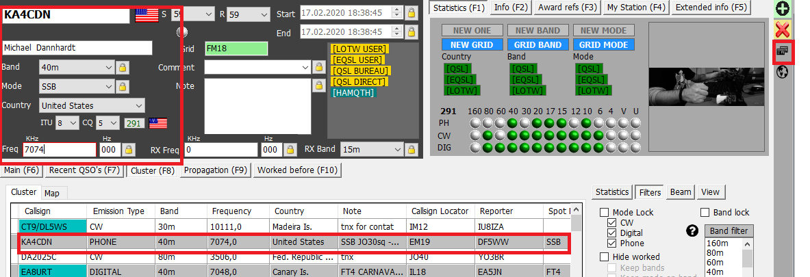

Re: Cluster spot : Emission Type determination
Hi Michael,
have entered your call, a mode, a frequency in the main UI and spotted via the spot button at the right
side. As you can see i have you with mode SSB at 7074 kHz and the spot is correct. Showing emission type
Phone and spot mode SSB .... All fine.

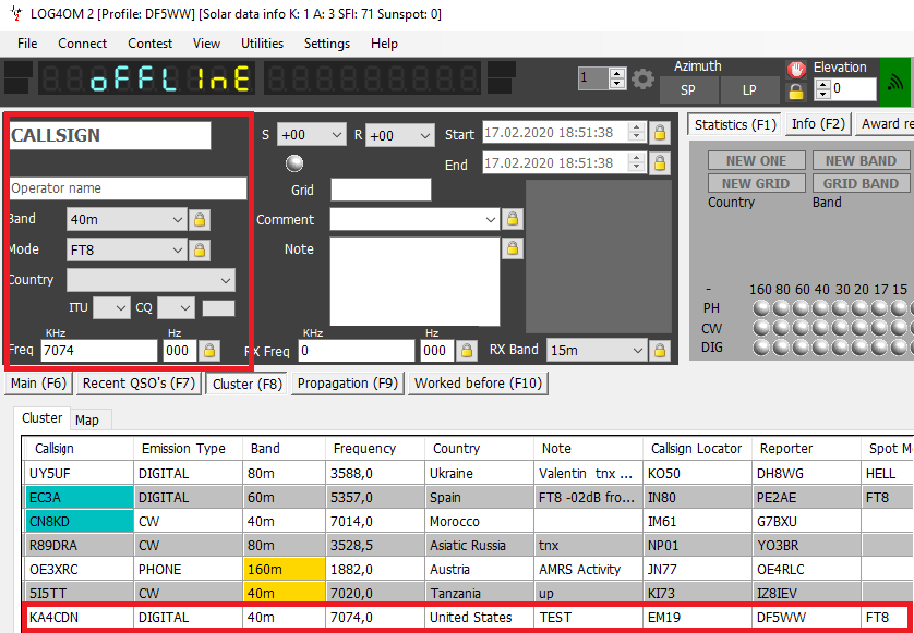

Doing the same now with no call set in the main UI but mode FT8 and frequency 7074 kHz. Using the telnet
spot simulation again with your call putted in in the telnet window. Now we have these:
So that means, if anybody has set FT8 as mode in his logger and his bandplan said it´s digital and the mode
is FT8 he will spot emission type digital and spotter mode as FT8 .....
Think we can´t do nothing to change this. Example, you have set Mode to SSB and frequency to 7022 kHz it could
be possible that you spot and/or test spot from telnet shows Emission type CW and spotter mode SSB ...
