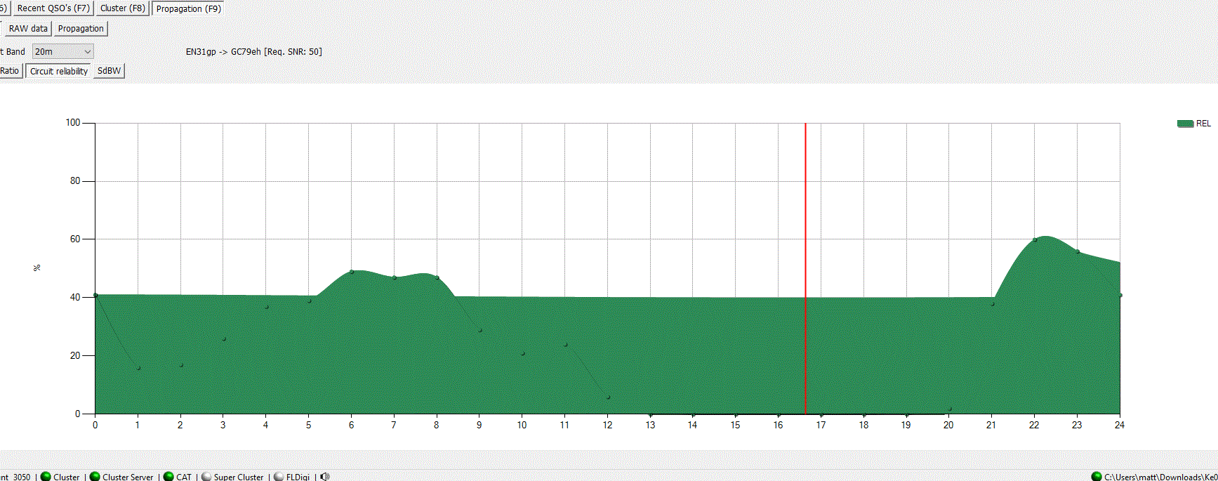

I occasionally get an issue with the circuit reliability graph.
I have a friend that I was trying to explain how it worked and he did not understand. He sent me a screen shot.
This is exactly what I see on occasion.
Note you can see the proper graph (dots) if you look close.
wonky stuff.gif (185.1 KiB) Viewed 6564 times

Looks pretty much to be a screen clip of the main UI.

This was a screen clip from KE0IAT. I have seen the same on several occasions.
The reason you do not see the B4 tab is its clipped off right below that.
I have closed log4OM and came back in to same call and band and got same results. So I dont think its a video refresh thing.
So at least two of us are having the issue.
Rich

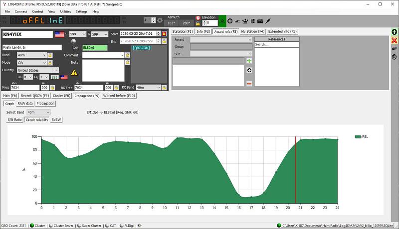

FWIW ... below is a screen clip of my V2 UI this afternoon.

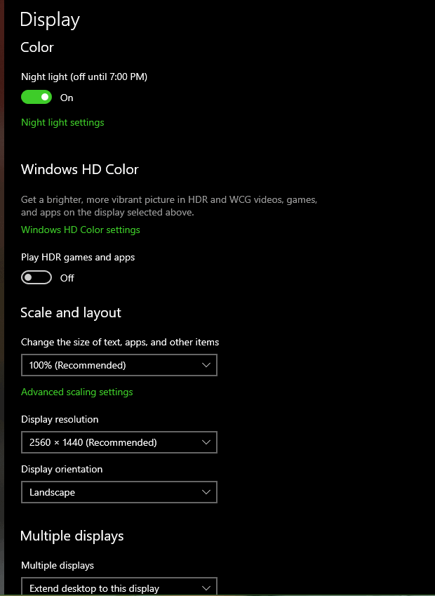

Another question ... do you have your Windows display set for default of 100% with no percentage increase for a somewhat larger display?
I've seen (even on my system) when I do such it tends to mess up some displays and image rendering.
Just a thought.
Re: Propagation issue
If you are talking about screen scaling. No. I run at full native resolution not scaled. And I agree, not all programs play well with that.

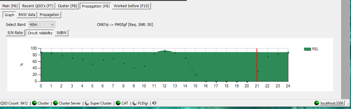

I can replicate that issue with my IC-7600. Just enter a callsign, then select Propagation tab, Circuit Reliability tab, display chart is fine, then change bands on the radio. That gets the graph all messed up.
Propagation Graph messedup.PNG (54.44 KiB) Viewed 6194 times
Thanks for reporting! The key was that a band change from the radio was the trigger. I'll add it to Mantis.

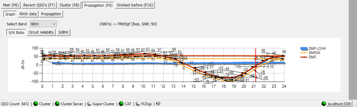

It not just the reliability tab, its all the propagation graphs, indicating its the data being passed, not just a redraw issue.
Propagation Graph messedup2.PNG (55.64 KiB) Viewed 6189 times
And it does not always occur is you single click on cluster to get a callsign into the main UI. Always seems to cause issue with manual typing of callsign.
