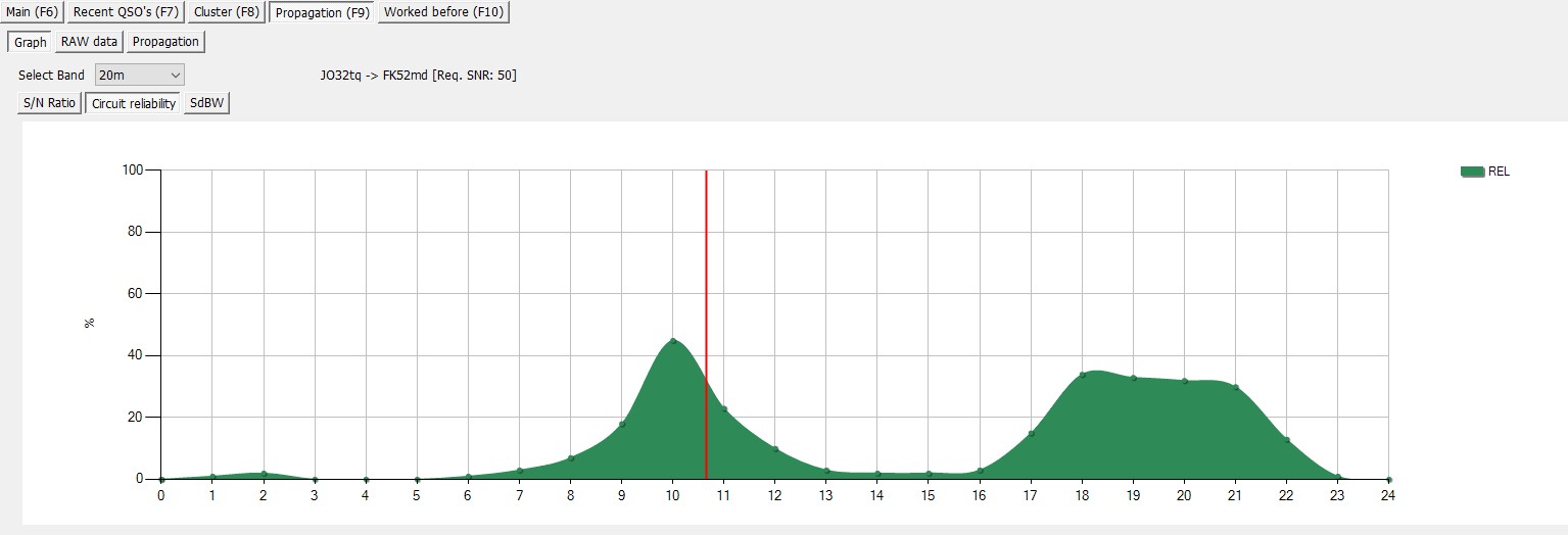

I am running win10 v1909 X64 Log4Om v 2.3.0.0 and omnirig
How often is the VOACAP data used in the propagation calculation refreshed.
I have already 8 days exactly the same Circuit reliability diagram for a specific station in PJ2.
Is the VOACAP data available once a month and is it the probability for part of the month or does it have to calculate the current situation each time?
Thanks, 73 Dick DL1CLM

- Voacap PJ2.jpg (78.47 KiB) Viewed 4209 times

Dick,dl1clm wrote: 24 Feb 2020, 14:33 Hi,

Re: VOACAP Propagation issue?
Thanks Nolan,
That's exactly what I do and yet nothing changes in the display, If I change my RF power the diagram will be different but if I go back to 100 Watts I get the same diagram for 8 days in a row now.
Try it yourself with my call at 20 meters a few days in a row.
73 Dick
73 Dick

Dick,dl1clm wrote: 24 Feb 2020, 16:47 Thanks Nolan,
73 Dick
Got some feedback from Danielle and he advised that data is taken monthly along with number of sunspots. That being the case one may not see any change from day to day or week, etc.. Depends upon what day of month that particular group of data is refreshed.
The constant we each have is our specific geographic location and antenna.
BTW - I've been taking daily JPGs using your call-sign and (goes without saying) ... no changes over those couple of days.
Hope this helps a tad.

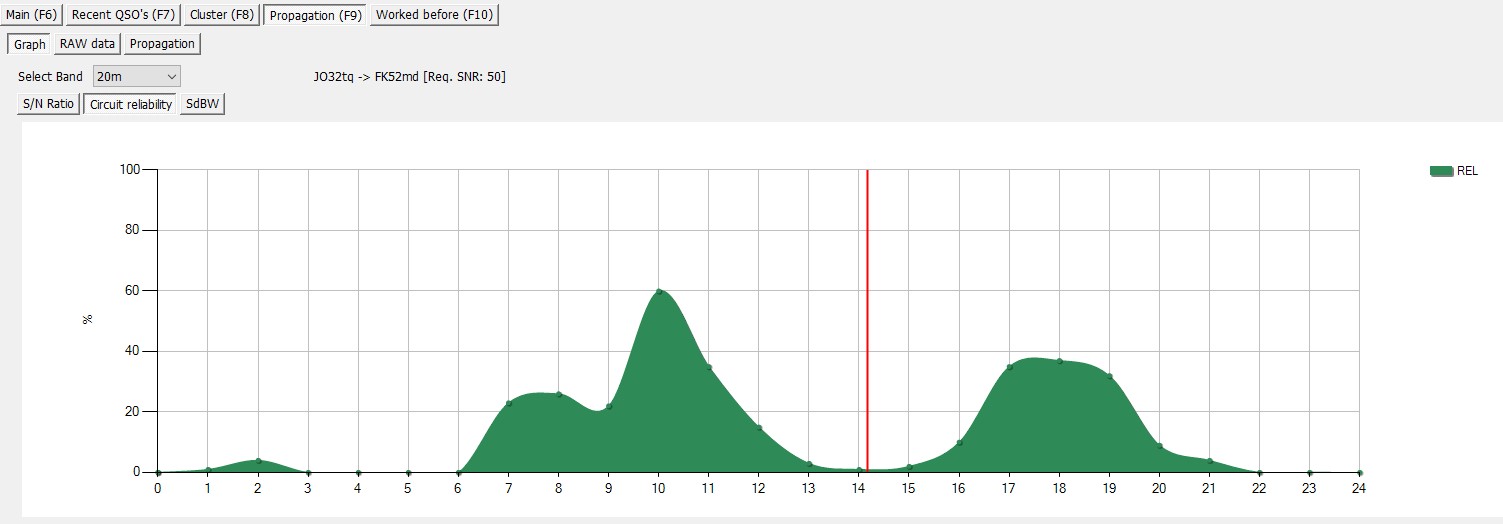

Thanks Nolan for your answer.
I have 11 days exactly the same reliability diagram for the connection with my friend PJ2LS.
I have been searching the internet myself and have read that VOACAP data is only renewed once a month. I am curious when this is and will monitor it on a daily basis. So it is a monthly forecast and therefore only has a limited value at the current time. I had hoped that the cluster colom reliability would have more value.
I am still very happy with Log4Om version 2 and hope that the other problems with the cluster, (cluster alert that hasn't worked since v2.3.0.0) will be solved soon. In earlier v2 versions it worked fine.
73 Dick DL1CLM
73 Dick DL1CLM
Today ( March 1) the Circuit reliability diagram for a specific station in PJ2 changed.
So it is not a problem, but a prediction that is adjusted once a month.
73 Dick DL1CLM
73 Dick DL1CLM
