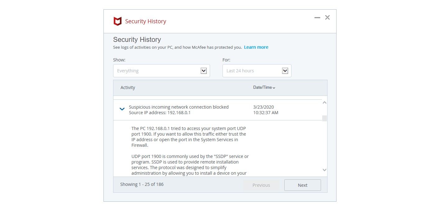

I am experiencing McAfee Firewall problems. McAfee appears to be blocking file updates requested by Log4OM. I am also being "Blocked" from using the Forums site unless I turn the Firewall off. This all seemed to start within the last two weeks. Is anyone else experiencing these problems?

same issue
It spotted some traffic on a port and blocked the ip address. In order to make the interface more user friendly it was difficult to manage BUT
eventually I managed to set it so that the ip address was trusted. So Firewall on and programme working. Apologies but it took me ages to find the right menu item.
I *think* I went to settings --> Firewall -> Net Guard --> Allow 94.63.24.40
