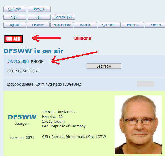

Hello OM,
not know what´s wrong at your side but here all is working fine. You need
to open Logbook site at HRDlog.net to see the On Air status ....

Re: HRDLog On AIR status
Hi Manuel,
he wrote in first post that the Box is checked but as you say, it could only be an elementary
thing like wrong login data or not connected to CAT. I´ve checked without a CAT connection
and On Air will not be show´n then. That make sense so for On Air a frequency is a must have.
