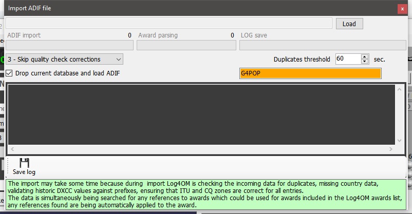

Re: Duplicate log entries
Export an ADIF file then reimport it but with the following settings
'Duplicates threshold' set to 60 seconds
'Drop current database
'Skip quality check corrections'
Load ADIF' checked
as in the image below.
MAKE A BACKUP FIRST
