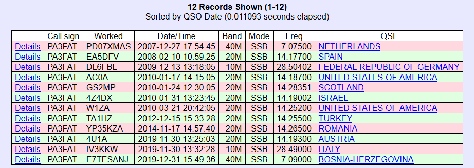

Have something similar.
Have 12 confirmations in Lotw, since whenever, adif gets downloaded. Only 1 QSO marked YES.
Where is the adif that is being downloaded so i can check the contents of LOTW download. For now i cannot see what is the actual content.
LOTW confirmed QSO since forever.png (64.37 KiB) Viewed 4022 times
tn_LOG4OM lotw status.jpg (8.71 KiB) Viewed 4022 times

Got mine ok, i think. I did "Last Download" marked and the "received since" in my case 1-nov-2019. That gave me the 12 records.
Selecting in a date range eg 1-1-2007 to 18-4-2020 (european notation) only gave me the last confirmed.
So there is something wrong in what is requested from LOTW or not all the fields are passed through.
Where can i find what is going to LOTW? So i might be able to give some feedback.
