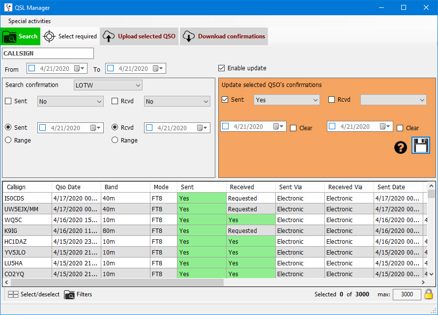

Is there a reason you do export the file and sign and upload in the manner you are doing it and not allowing Log4OM to connect to TQSL and do it for you? This would take care of your needs in one shot.
If you want to continue to manually export the files you can change the status of LOTW in the QSL manager.
Note that version 2.5.0 is just released so the image below is going to look a little different as some changes have been made to this part of the program.
But if you click enable update check box you will get the additional functionality on the right. Select the QSOs you want to change, check the set box and change it to the value you wish and finally click the save icon.
Rich
